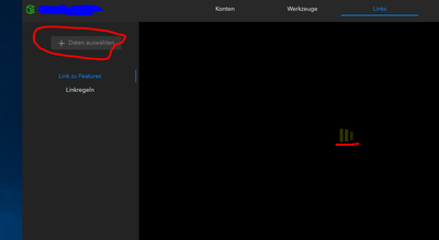

Hello,
We want to check the possibilities of GeoBIM. Unfortunately, I can't select the data in links and no map is shown. Can someone help @AnthonyRenteria ?
Thank you very much!!

Hi 3DMS.  Please provide a few additional details, either using a brief video, or with screen shots of the steps to get to this point. There are a few necessary steps to use this page:
  1. Authenticate with Autodesk--is it possible the Autodesk authentication page is hidden?
  2. Access map and basemap content--is this content available (you own it, or it is shared with you).
When navigating to the Links tab, you should see this page initially, which is what you have:

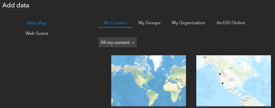

After successfully authenticating, you would be presented with a list of maps you are authorized to access:
If you do not choose a map, your organization's basemap should appear.

3DMS
@Anonymous UserThe authorizing with Autodesk works very well. But  I still have the problem with the links. I am not able to see the map in links or select date!StephenBrockwell
