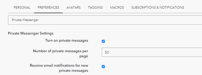

Seems like you don't have PM (private message / direct message) enabled. If you enable it I can send you my email address, or you can send me your contact details, in case you would like to share your IFC models.
