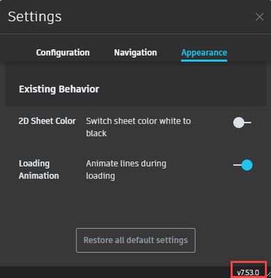

Thanks for the clarification. There are/were a few uses of the "Forge" name that causes some confusion. In this case it is the Forge Viewer. The current release of ArcGIS GeoBIM is using version 7.53 of the Forge Viewer. This is specified by the GeoBIM app. You can also see the current version if you open the settings in the Forge Viewer.
