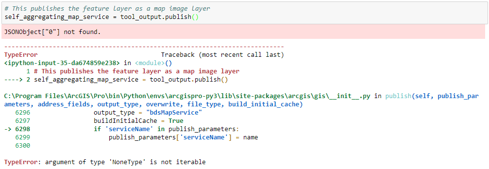

Self-aggregating layers are a really exciting visualization to create, so I'm trying to do a very similar implementation with a comparatively modest dataset of 800K points on GeoAnalytics Server. I was able to replicate every step, including the CopyToDataStore tool (it ran the distributed job, and I was able to add the result to a new map). But then wasn't able to publish on the final step. I'm pasting the error I'm getting below. I received the same error when trying to use the Generate Map Service option at the feature service REST endpoint. Do you have any idea what might be the problem? Thanks for your help!
SarahAmbrose
Hi Daniel,
Can you confirm for me what version of Enterprise you have (you'll need 10.6.1) and what version of the ArcGIS API for python you have?
Thank you!
Sarah Ambrose
GeoAnalytics Product Engineer
