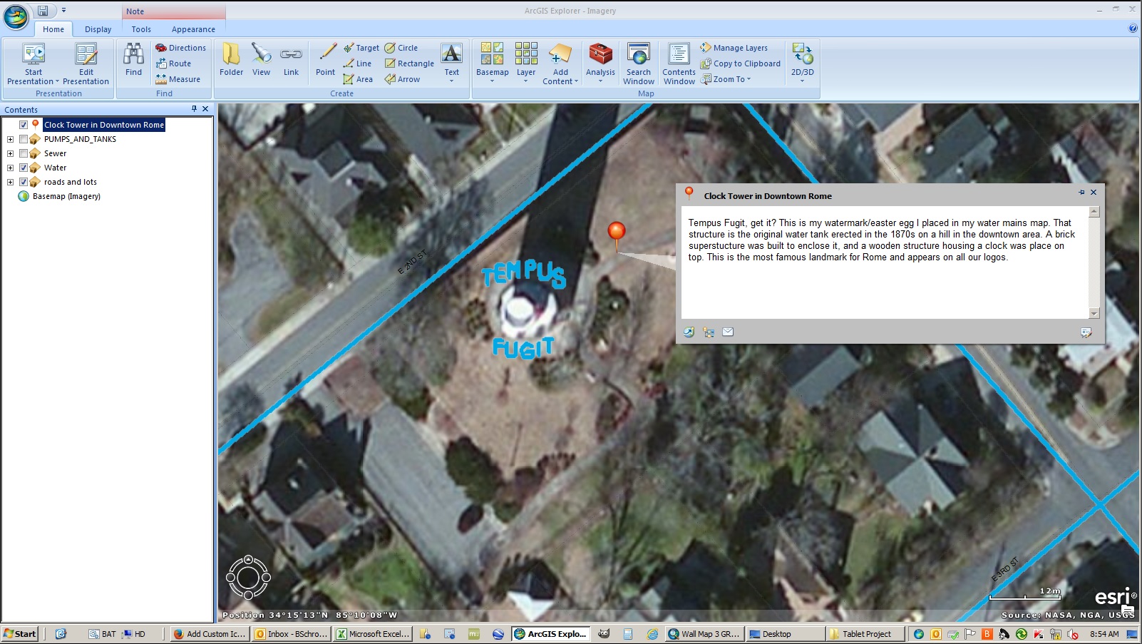

This is in Explorer, the original pin.

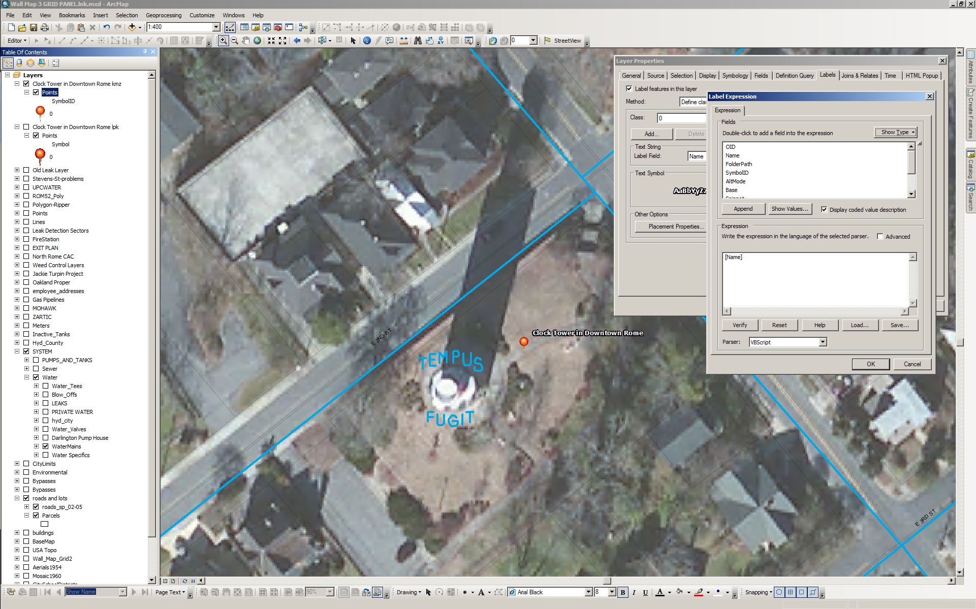

This is the lpk file in ArcMap. Nothing I check in labels will display anything.
This is the kmz file imported into ArcMap. The only thing that appears is Name. If I add ANYTHING else it's blank.

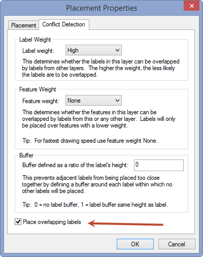

I think this is just an issue with labeling in ArcMap.   I can reproduce the same issue.
If you set placement properties for the label you can make it show up, but it won't fit on the screen and won't look that good.
In the labeling properties.
I placed the label on the point.
I then set the Conflict Detection to place overlapping labels.
This labels the point.

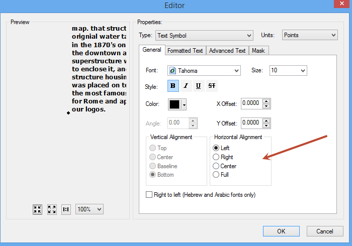

The script removes the <style> tags and wraps the label text for display on the map.
To set text alignment use the Symbol Properties
