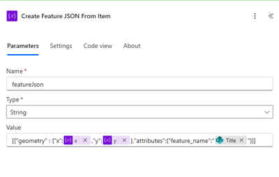

After I have my x and y coordinates parsed and available, I find it a best practice to initialize a new variable to create the JSON for my feature. Just remember that when you add string data into the attributes section from your list item response, you need to surround it in quotes for proper JSON syntax:

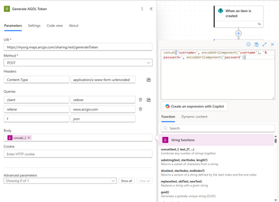

Once you have the feature json definition ready, you can generate a token, and sent the POST request to add the feature to your AGOL layer. (If you are doing a batch of features instead of one, you should move the generate token action to before your "Apply to each" action set so that you aren't creating unneeded overhead). So first, generate your token:
