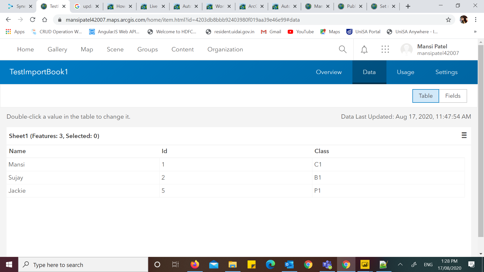

I have same issue that i am updating excel file in my one drive but changes are not reflecting on AGOL data tab.
i also wants to update a data in AGOL when changes occurs in excel on one drive but without manual operation.
Is this possible or not? can anyone suggest me right path?
Below, i have attached screenshot of data in AGOL while excel has more data entered but its not showing me in AGOL. you can check screenshot of excel data as well.
Thanks a lot in advance.
