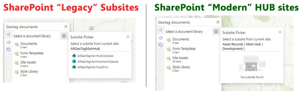

I'm a SP Admin/Dev and installed the ArcGIS SharePoint Webpart in our MS Tenant.
Did a quick POC where I was able to display SharePoint GeoTagged documents across multiple SharePoint SUBSITES with ease. Geotags wrote to the SharePoint Term Store perfectly, etc...
The problem is that I have architected project with the more modern SharePoint HUB sites.
Are there any plans to implement HUB Site picker in the webpart when geotagging SharePoint Document Libraries ? I acknowledge the complexity of traversing 3 or 4 hub levels to aggregate doc libraries.

@BrianLabelleSMLP - Thanks for reaching out to us. I really appreciate your question. Currently we do not support "Hub sites" for the geotagging workflow. But I am going to add this to our backlog, discuss this with the leads and provide you an ETA as to when we can have this enhancement available to our users. I will keep you posted.

I am 75% sure that when you "move" a tagged document from a "sub site" to a "hub associated site", the tags will get transferred with the document(s). You just need to make sure that the library where you are moving the document has the column for "Managed metadata" and the termset is pointing to the same termset used for storing ArcGIS for SharePoint terms or geotags. But I can get back to you by end of next week if this is 100% possible.

I wanted to let you know that once you geotag documents (using the ArcGIS for SharePoint app) in your subsites and if you "move" the documents to "hub sites", the geotags will be preserved as long as the following are met:
1. The hub associated site(s) to which the documents are moved has a managed metadata column
2. The managed metadata column in the hub associated site(s) uses the same termset as the one that's used for storing the geotags from the ArcGIS for SharePoint app.
I'll keep you updated on the progress and also an ETA as to when we will rollout this feature.
