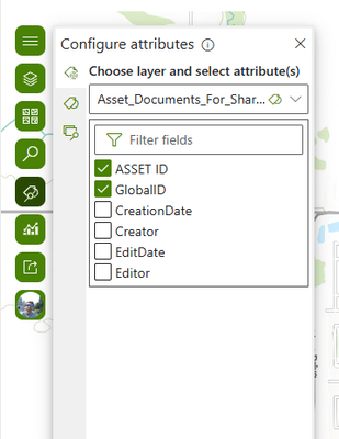

KhemAryal
Hi, @RaajRaaj
We’re using ArcGIS for SharePoint version 2025.3.1.0, which I believe is the latest. However, I still don’t see the “Add Document URL” toggle. I’m working with an AGOL-hosted feature layer that has editing enabled, and I’m the owner of the layer. Geotagging works fine and the tagged documents are accessible through GeoSearch, but the link doesn’t appear in the feature pop-up. Your thoughts
RaajRaaj
Hello @KhemAryal --
The screenshot that you shared last week, is that from the 2025.3 version or is that from an older version of the app?

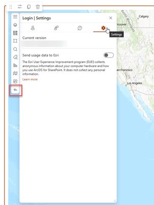

Hello @KhemAryal --
The screenshot doesn't reflect the new design we've implemented since the first release in 2025.
Here's a screenshot from the 2025.3 version. When you open "settings" from the main menu/toolbar, can you see what version number is mentioned under "Current version"?
Thanks & Regards,
Raaj

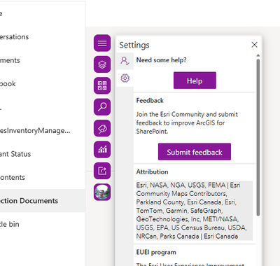

KhemAryal
@RaajRaaj I do not see any version number there
RaajRaaj
@KhemAryal - It's definitely not the 2025.3 version. Could you please show the screenshot that I shared with you to your SharePoint administrator/IT and have them verify if the app has been installed and enabled on your site?

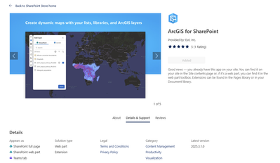

KhemAryal
@RaajRaaj
This is we have
RaajRaaj
@KhemAryal - Its quite possible that the IT administrator has not installed/enabled it for your site. The other option I can suggest is to remove the web part from your SharePoint page and try adding the "ArcGIS" web part once again (after clearing your local cache). Unless I can see it directly, I am afraid I cannot clearly pinpoint at what could be wrong.
Thanks & Regards,
Raaj
