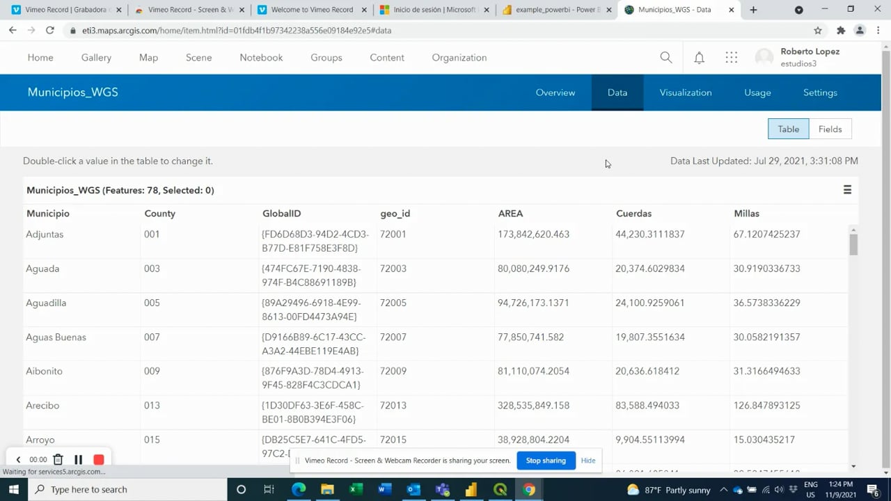

However, this is a video I recorded showing what happens when I try doing the join myself: https://vimeo.com/644026377/041bd3b6ac

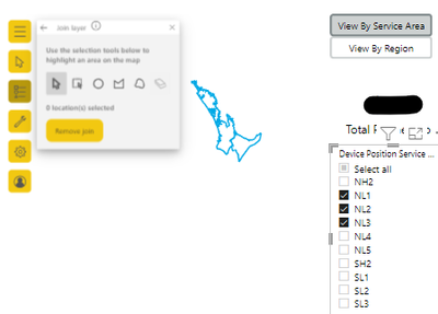

I have the same problem, if you leave the JOIN layer pop up open, as per my screenshot, it will allow you to use the filter.
17 Replies
ismaeloltra
estud1os_113
Wow! Thank you so much! Not ideal but it works! Hopefully this bug will be corrected soon.

@Anonymous User I'm experiencing the same issue. Filters only work if the Join layer window is open. This is with version 2021.2.95.

I was looking over a few of these comments related to the Join layer feature. Currently, to use this feature, the Join layer widget must remain open while making selections. The reason for this is because of some unique infrastructure/environment variables that are currently preventing us from accessing and selecting these items directly. For example, if you have a Power BI Data layer on the map (e.g., addresses), the selection tools will only interact with the Power BI Data layer when selecting them.
We are currently enhancing this feature and working on some BUGs that were reported, however, there is always room for improvement in general.
