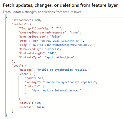

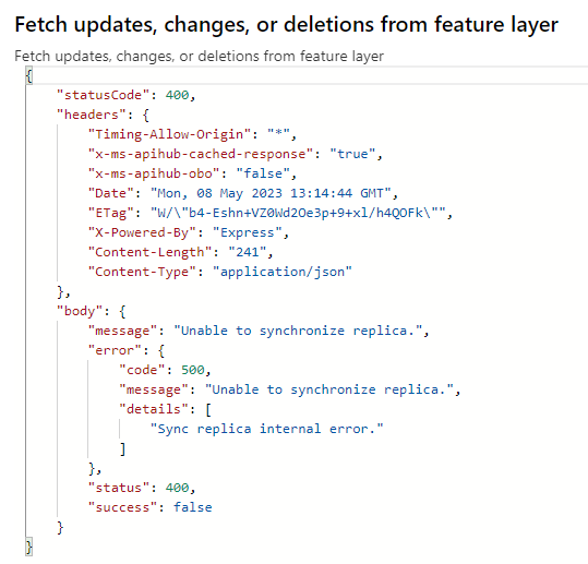

I created a simple flow 3 months ago using the arcgis Connector. When a record is created, get some of the information and send an email. Everything was working fine until May 1st (as of Friday April 28th, flow was working as expected, Then starting May 1st, flow stopped working returning following error:)

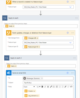

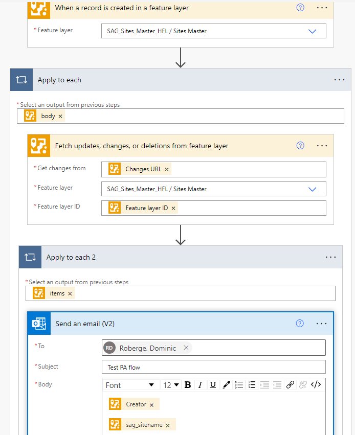

This is the basic flow:
I have tried with different feature layers and ALSO with different office 365 sites and I am getting the same results.

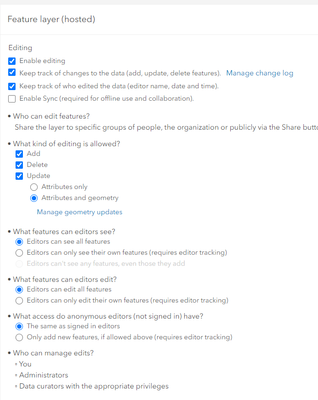

DominicRobergeIADOT
nope, just shared with the Org and with the following settings:
