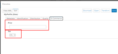

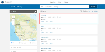

I am using a custom profile at the moment with a few extra fields /values and I am trying to add them in the card item, for example.
Can this be done?

hi, yes, this is possible. For this you should start by looking at ItemCard.js and the corresponding template found in ...\geoportal\app\search. You will find a number of renderer functions here (for title, thumbnail, etc). Each one has a corresponding section in the ItemCard.html template. The key is to include a data-dojo-attach-point attribute in the div element. You would then add something like a 'renderEcommrce()' function and call it in the render() function. You will pass in the item (as you will see in the existing renderers). That item will give access to the information in your item.

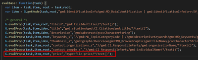

I tried adding something like this in the EvaluatorFor_ISO.js
but this doesn't work. Any pointers on what I am doing wrong?
