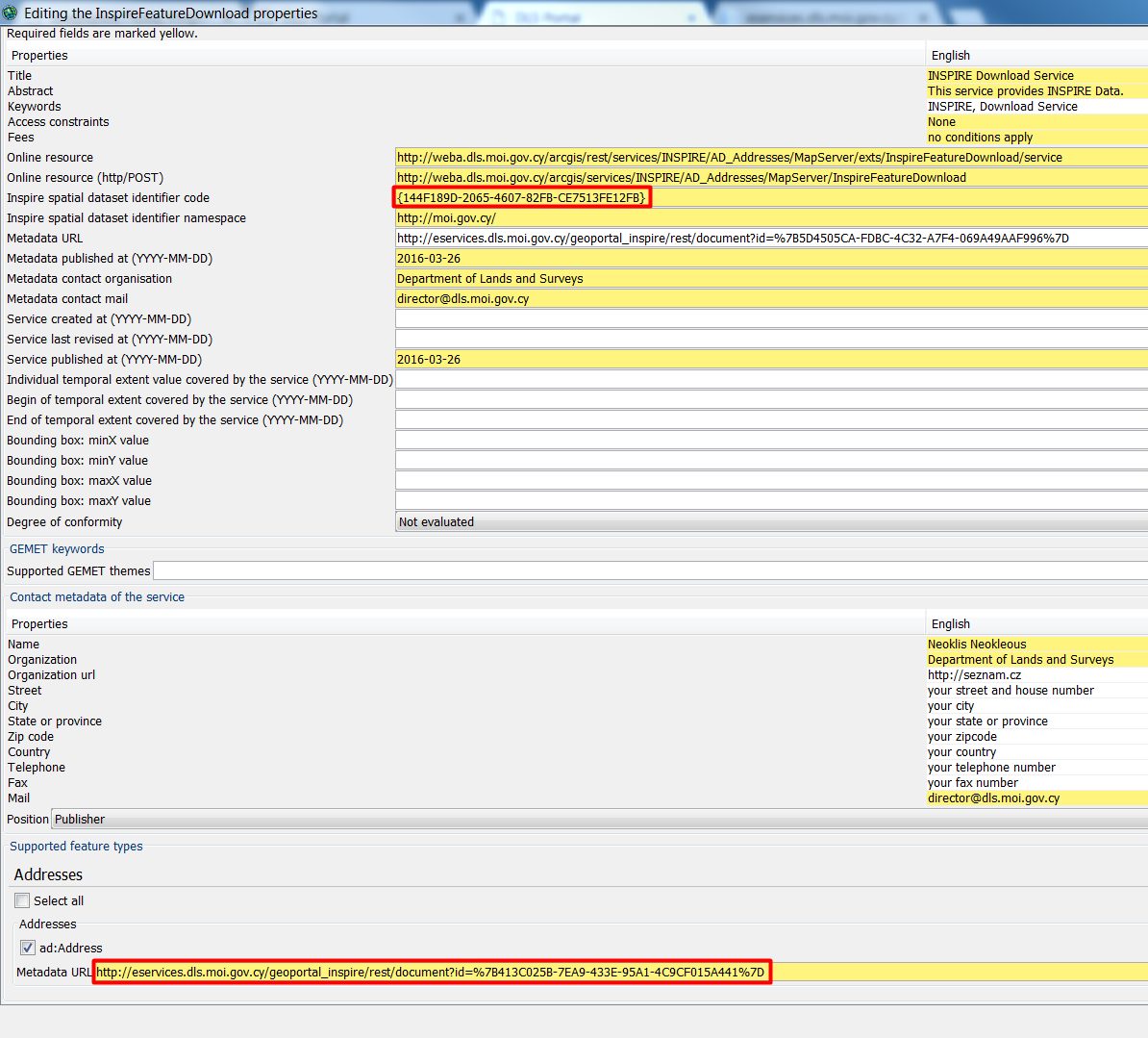

Hello. I need some help in the configuration of the Service Editor in ArcGIS for INSPIRE.
Specifically I have a Datatheme with more than one stakeholder. I have published a single download service (WFS) but I also have created Data Metadata for each stakeholder regarding that Datatheme. How can I associated all stakeholder’s metadata with that WFS service?
Below is a screenshot showing in the red box the values for one stakeholder. I don’t see any other way how to add the information for the other stakeholder. Maybe it’s not necessary? Am asking this because in the configuration of the View service, i can add all my stakeholders necessary info in order to associate the View service with the stakeholder's metadata.

Currently it is limited to one metadata url for a feature type on the interface, if you need to add multiple urls, you can try to edit the capability file manually by copying and adding more metadata section like below:
<MetadataURL xmlns="http://www.opengis.net/wfs/2.0" xlink:href="http://xxx/geoportal/rest/document?id=%7B7F793BE5-B828-44B1-8A13-0A140C131127%7D"/>
The following page has information on how to custom a capability file:
Create the feature download service—ArcGIS for INSPIRE | ArcGIS Enterprise

MichaelMichaelides
Thank you for answering my major question.
Also does it matter if i don't change anything? I mean in the context of discovering the WFS services by another harvesting site?
