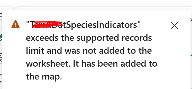

Got this message today but I cannot find anywhere what the limit is?  We have some up to 8 million and I do not expect that but need to know what it is.
Also how can I limit it somehow?  We can make one excel file per state but how would I do that if I get stopped right away?  Would I have to make 12 different state maps and load from those?
A way to add a query before the pull would be pretty sweet I guess.  Is this possible at all?  Then I could pull 1 state and it would all be faster.

For ArcGIS for Excel, the following limits apply:
  • Max row - 1,048,575
  • Import to Excel (column limit) - 16,384
  • Max row per sheet - 1,048,576
  • Max column per sheet - 16, 384
  • Cell character - 32,767
Hope this is what you were looking for! Let me know if there is anything else I can assist with!

Thanks.  Why the 1 million limit?  That went away with xlxs format so its possible now I think.
ShannonCardoza
I would need to ask our developers for a concrete reason but from previous conversations, if memory serves correctly, we did NOT want to NOT add a limit and expect to support an 'unlimited' number of items/rows/columns so we try to align as close as possible to MFST Excel limits. @DougBrowning
