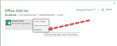

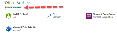

Nonetheless, to remove an add-in, you must access the add-ins directly from the Home tab by selecting Add-ins.
Then select the +More add-ins option
If the add-in was added through the admin center and you are not an admin, you cannot remove it. If you see the (...) you should see the option to delete add-in. Here is an example of admin center control:
Here is an example of when the option to manage add-in's is available:
This may vary a little depending on if you are using Desktop or web browser but the gist of the workflow is the same. Hope this is helpful!
