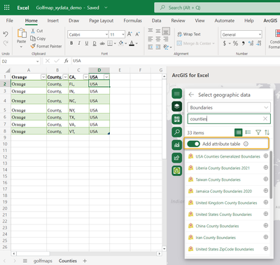

Hello again! It is possible to fetch or Add the (related) attribute table when adding an ArcGIS Online feature layer.
We do not have an import map function but if you would like to reply and elaborate on bit more on your workflow, I can assist further.

Good morning @WarrenMedernach thank you for the additional inquiry. At this time, I believe there is a limitation to importing the project table. I assume you are using ArcGIS Pro? But please confirm.
Also, the option to Add attribute table will need to be toggled 'on' for feature layers (assuming the correct permission/role is assigned to the user).

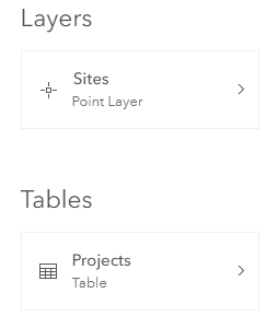

I might be mistaken, but I think the OP is asking the same thing I'm trying to figure out and that is: how do I bring in a feature layer and its attributes, as well the related table(s) for this feature layer?
For example, I have layer and a related table like this screen cap below. I can bring in the Sites table to Excel, but I would also like to bring in the related Projects table.

WarrenMedernach
Hello Shannon, thanks for the reply.
Adding the attributes for a feature service is not the problem, and that functionality works great. What myself, and others in this post are asking about is bringing in the related table data/attributes in addition to the feature service attributes.  Based on your response it sounds like this capability is not yet available.

ShannonCardoza
Good morning @AnninaHirschiWyss , thank you for the question. In order for our add-in to bring in or fetch the attribute table for a feature service there are 2 items that need to be completed. 1. the correct permission/role for the user and 2. Toggle is set to 'on' for Add Attribute table.

AnninaHirschiWyss
Hi @ShannonCardoza I’m not talking about the attribute table of the feature layer, but the standalone table related to other feature layers in my feature service (as the ´project’-table in @WarrenMedernach sample). Please make that happen, as it seems, according to your own post that it is not (yet) implemented, so kudo this idea
