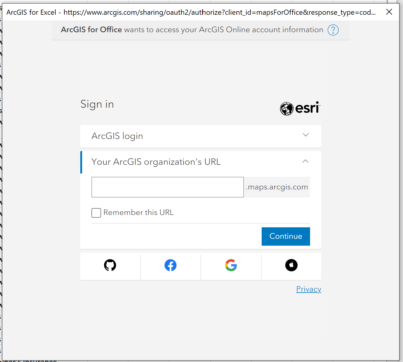

The option to Sign In using our enterprise portal is not available in some instances.
Trying to work through the ArcGIS for Excel Basics training tutorial.
When I try and sign in I only get the options of ArcGIS login or ArcGIS org url. I want to use our ENT portal url.
In the past I was able to work around this (when we had the odd la.arcgis error), by opening an empty excel document, signing in to our ENT portal and then opening the data file I needed.
Currently when I try this it pops up the standard ArcGIS log in (above).
I am able to open an empty document and sign in through our ENT portal, but as soon as I try to open the training file it wants me to sign in using the windows above.

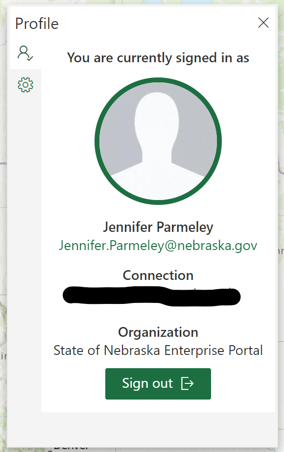

Jennifer_Parmeley
I created a support ticket with ESRI associated with the training issue. I found that the issue persisted when using data in an excel sheet we created. It looks like this is by design and not seen as an issue.
You have to sign in to AGOL in order to geocode in Excel.
I signed in with my enterprise portal, set up the geocode, and still had to sign in to an AGOL to get the "add to map" button to work. Looking at the portal/sign in after the geocode I am still signed into the enterprise portal. In this case the AGOL sign in doesn't appear to do anything.
If signed into our enterprise portal and using a custom locator no credits were used from the AGOL account.
If signed into our enterprise portal and using ESRI world geocoder, credits were used from the AGOL account.
There is no warning or notice on credit use in Excel.

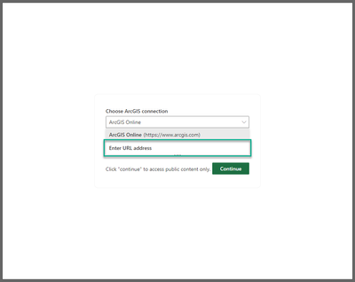

ShannonCardoza
Good afternoon @Jennifer_Parmeley
Based on your description above, I believe this is an easy fix. You may reset the map and be provided the option to set your URL.
1.
2.
Thank you for reaching out. Please let me know if this is helpful!

Jennifer_Parmeley
@ShannonCardoza is this a new feature? I had a support ticket with ESRI on this and they did not give this as an option, for switching portals.
After using the Reset Map option, I signed into our ENT portal. I am still being asked to sign into ArcGIS Online when I try to geocode (add points from an address). I can add points from x,y, but not from an address.
