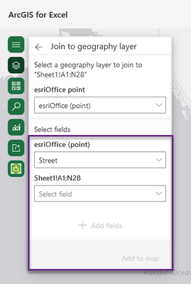

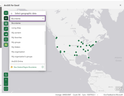

@eric3918esridot Good morning! Thank you for posting your question. Let's try to troubleshoot a bit. Can you help me understand the exact workflow?
1. What did you choose for 'Select Geographic data'? A boundary or My content, etc.
2. Did you add 1 field or 2 or multiple? If I add 1 field the 'add map' button appears greyed out. If I add another field, the button is available.
