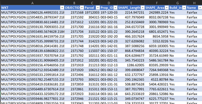

My suggestion goes to two steps:
1. Export geometry to text (into attribute)
2. Save feature table into  CSV/XSLX like below
I don't sure what's steps should be done in ArcGIS Pro?
Thanks for any advice

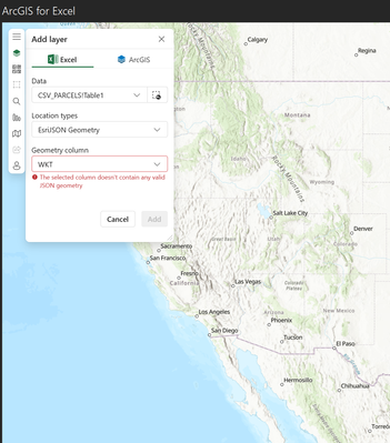

Hey Shannon @ShannonCardoza,
Thanks for your answer, but it's still not what I'm looking for..
Why?
For me, A4E plugin is a good step to inspire people - who don't know too much about GIS systems.
I know about hosted features, but...
In this scenario, a people have to be a part of my organization or we have to publish content to the public - it's not a good every time. I'm talking about data integration for people, who are out of my organization and working only with Excel app.
 I'm not sure if this tool designed most for points, I did some time ago, sucesfull conversation from Polygons to EsriJSON (text) but using FME app by "GeometryExtractor" tool..
So, How do achieve the same results by ArcGIS Pro?
If we wanted to put only points by A4E, In my opinion, the best way is to export it into X, Y and select the Coordinates option with custom EPSG code - but still not sure how to achieve the same results for EsriJSON geometry?
Because I guess its a bit tought to import geojson format into Excel - the documentation does not show any steps on how to integrate Excel with EsriJSON geometry, right?
The FME app have tool to deal it - so I guess developrs who deal this opiton (EsriJSON Geometry) know way how to work with that.
PS: I'm also compelled ArcGIS for Excel Basics course, I can't remember were there realize case like that
Thank you!
