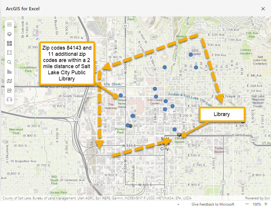

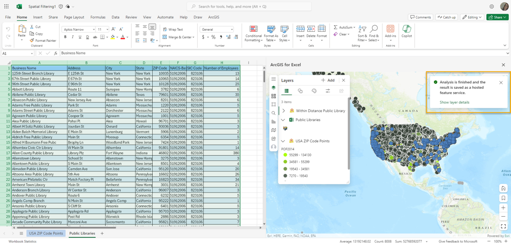

For example, I have added 2 layers. The layer to filter is US Zip codes. The layerto filter by is Public Libraries. I want to find all the public libraries within a specified distance of a US Zip code.
The goal is to determine how many public libraries are available within a 2-mile distance of a zip code.
(view in My Videos)
Result -
(view in My Videos)
Result -
