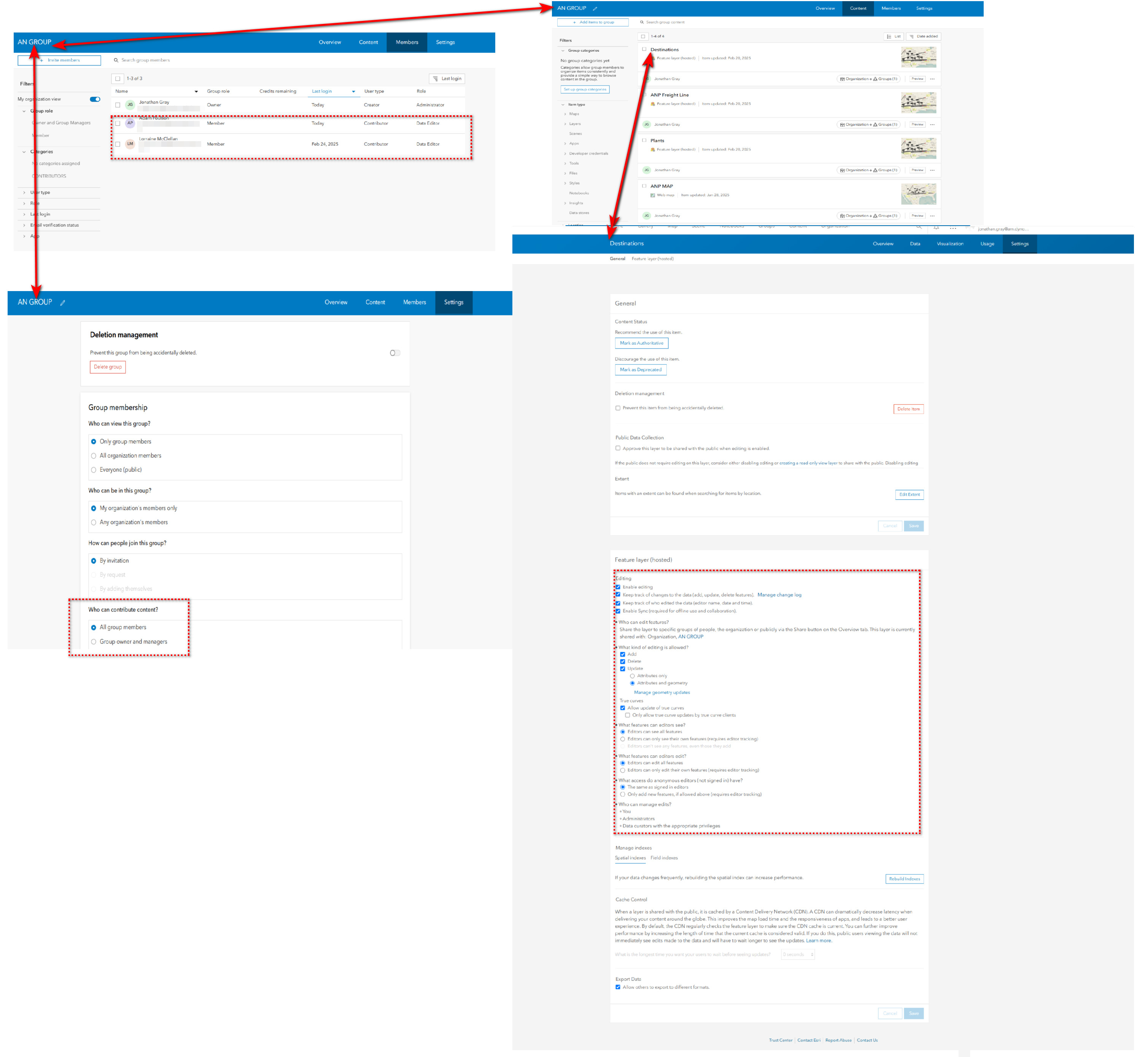

I’ve attached an image for reference and outlined all my settings here in case anything is unclear. The same image is included in this text and also attached as a file in case it's easier to view that way.

   So I thought I would give a little more info about it all—some of this is kind of a repeat from what I said above, but I’m just trying to be completely clear about my current setup and the problems I’ve noticed.
I tried creating a new group with Shared Update enabled, but I can only add the other Admin (the one who originally set up our ArcGIS Online account), not the rest of the team. I’m an Admin with the Creator role myself, so I’m not sure why it’s blocking me from adding Contributors. Could this be an Org or licensing setting I’m overlooking? Just wanted to toss out there this part of information.
Back to the real question, I’ve made sure all data editing options for my hosted feature layers are enabled—Add, Delete, and Update (both geometry and attributes)—yet I’m still wondering if there’s somewhere else I need to explicitly grant edit permissions. My main goal is to let Contributors with the Data Editor role bring attribute tables into Excel using ArcGIS for Excel. I assumed that if they’re in a group with access to the layers, they’d be able to edit and sync changes, but so far no luck.
Is it possible they actually need the pricier Creator license? I hope not, because that would defeat the whole purpose of having a cheaper Contributor license. If anyone can shed light on this, I’d really appreciate it—ArcGIS Online can feel more complicated than it needs to be, sometimes and I am for sure hitting a road block on this one.

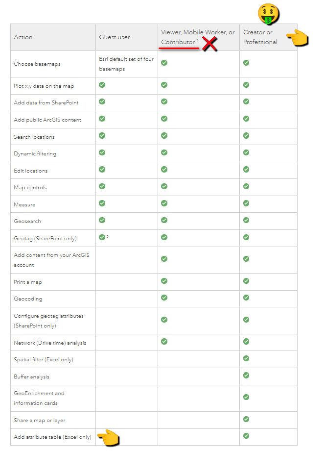

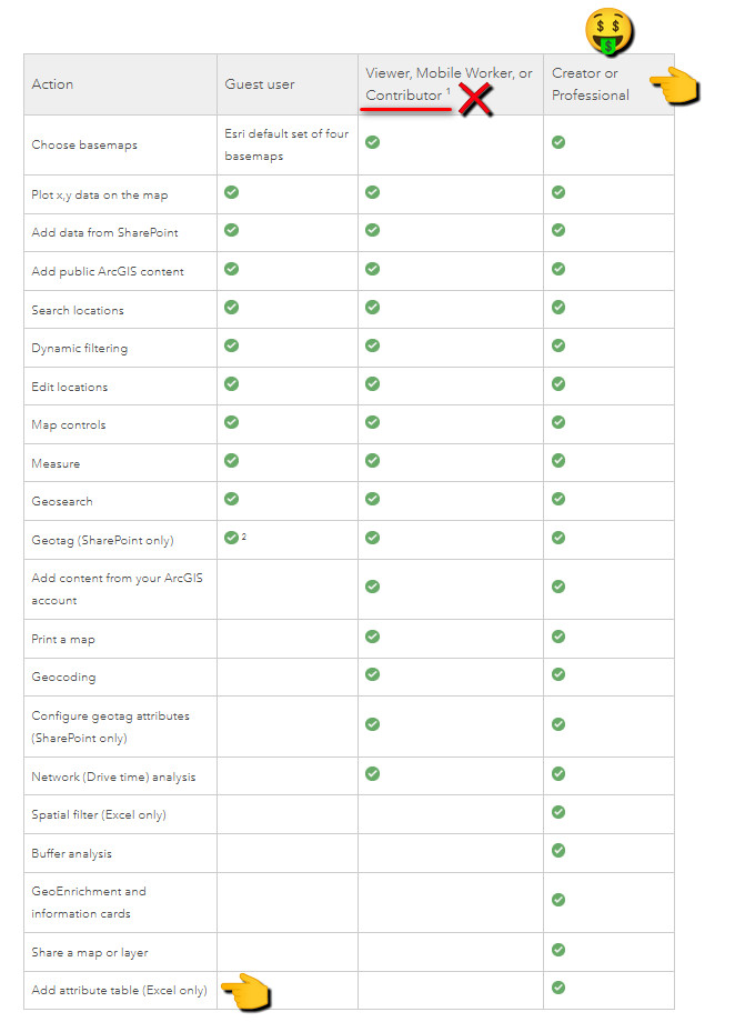

Update-Figured it out.
The image below pretty much explains everything, but here’s the interesting part:
If I set up an Excel file as the creator—pulling in the attribute tables first—then send that file to someone with a Data Editor role, they can fully edit the table. However, they can't add new attribute tables themselves. That said, they can still add as many layers as they want in the ArcGIS for Excel plugin’s map. They just don’t have the ability to pull in attribute tables on their own.
Now, I’m looking into Power Automate for a workaround because I really don’t want to spend an extra $700 on more Creator licenses—or be the one setting up Excel files for everyone. Hopefully, the ArcGIS Excel Power Automate tool solves my problem… TABLE.jpg
