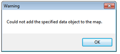

- Conversion from CAD to Geodatabase using that tool, and then adding a projection with the "project" tool. Both of these tools run successfully, but the resultant file gives the following error when I try to add it to the map:

There is a point located at 0,0 which is will affect the zoom to layer to zoom out to a large extent.
The other important aspect to take into account, is the spatial reference the data frame has when you add the DWG. If it is geographic (lat, long) the planar coordinates will be interpreted as decimal degrees and make no sense at all.
Start a new session of ArcMap, don't define a spatial reference, add the DWG and zoom to X=522300  and Y=4821500.

I'm confused by this: "Conversion from CAD to Geodatabase using that tool, and then adding a projection with the "project" tool. "
The CAD file comes in an unknown CRS. You do have the option to define a CRS in the CAD to Geodatabase tool, however you don't mention using it. So, the output feature class in the geodatabase should still be unknown. The project tool should (correctly) not allow you to run it, since the CRS in the input feature class is unknown. Did you mean "Define Projection" tool, rather than "Project", or have you defined the CAD CRS at some other point?
The take home point: you need to know and define the CRS somewhere along the line.

One way to resolve this is when the "CAD to Geodatabase (Conversion)" tool is run.  There is a provided option to choose a spatial reference.
As both Darren Wiens and Xander Bakker pointed out, you will need to know what coordinate reference system the CAD file should be in.  Given that the visible drawing elements are not at X,Y close to 0,0, it looks like a coordinate reference system was probably used.  Note that it is common for AutoCAD dwg files to be created without using a common coordinate reference system, in which case typically the drawn elements begin at or near an X,Y of 0,0 (the lower-left corner.  These cases can be difficult to work with, as they are essentially in a "local" system).
So the challenge now is to figure out what the coordinate reference system (crs) that was used.  I'd contact the source of the dwg file.   Be aware that CAD folks don't use CRS like we do in GIS, so you may have to do some explaining/educating so they realize what you are after.
