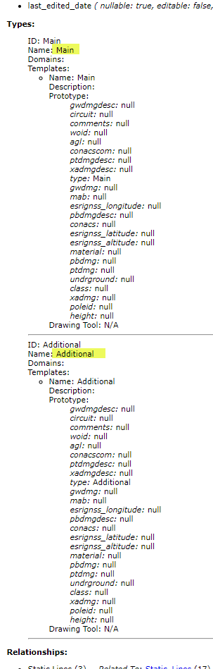

Okay so when I am pulling online layers into AutoCAD the table is only giving me two names within my Status(Type) Domain. When I pull the same layer into Pro it maintains the entire list. Does anyone know what I have done incorrect to have it not read the entire domain? Some of the list was generated in the online environment not exported out to the hosted feature layer.
First two photos are what is pulled from Pro and last photo is the same layer with available options in AutoCad. Any advise?

I appreciate the URL for the service in question. If we review the fields we see the field named "TYPE" contains the domain names we are looking for. However, scrolling down the REST page just under these fields to the TYPE heading we see there are only two of the five domains we are expecting (Additional and Main). ArcGIS for AutoCAD is reading from the REST endpoints TYPE section to determine the domain list.
Perhaps you can determine what caused this during publishing, but if not I would suggest calling Esri Technical Support > Enterprise Usage. The Enterprise EXT team would support ArcGIS for AutoCAD.
