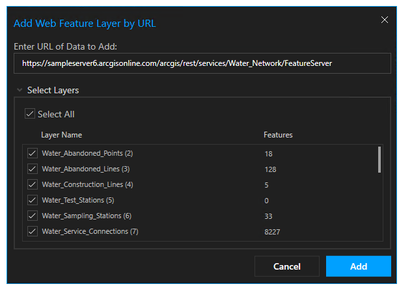

Thanks for posting this Idea to the community. The 440 release of ArcGIS for AutoCAD in Nov. 2025 includes a new user experience for you to supply a URL and then add the supported web feature layers of interest. This allows for you to work with supported feature layers under both featureServer and mapServer URLs.
With version 440, you can navigate to the ArcGIS ribbon, select the pulldown under the Add Data button, select Add Web Feature Layer by URL, and then specify the URL of interest. Here's an excerpt from the version 440 doc that shows the dialog. From there, you can select the web feature layers of interest to add.
