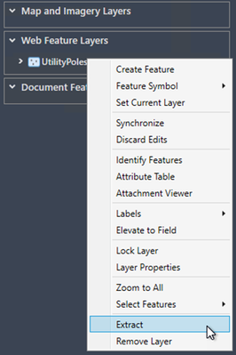

Once the web feature layers are published, the CAD team in your organization carries out the following steps:
  • Add web feature layer(s) to the CAD drawing by using the Add Data UI from the ArcGIS for AutoCAD ribbon.
  • For each web feature layer of interest right-click the layer to open the context menu.
  • Select Extract.
Each extracted web feature layer now resides under the document feature layers section of the Esri Contents pane for ArcGIS for AutoCAD.
These layers contain the specific geometry, attribute fields, domains, as well as any subtypes. The CAD drawing is also set to a specific Coordinate System, which if not already assigned, was automatically set when the first web feature layer was added.
