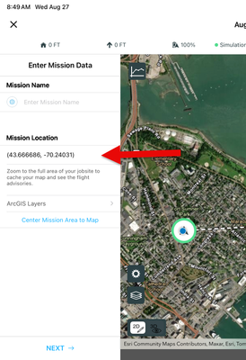

@JakimFignole These are great requirements and I would like to share we are working on some enhancements in this very area in the app that should be available next year. In the meantime, I have some ideas you could try.
1. Use the "Mission Location" search feature when planning your flights to search for specific coordinates. This should search for that location and center the map at that location.

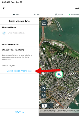

2. Then tap the "Center Mission Area to Map" button in the mission data panel. This will move the panoramic location to the center of the map which should be the coordinates you just entered in step 1.
