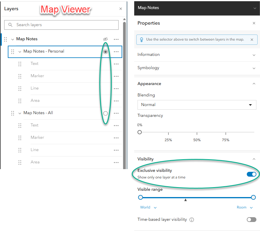

I can't see if I'm doing anything wrong, or if this is expected behavior (and Field Maps is not at parody with Map Viewer and Experience Builder).
I have set a group layer to use Exclusive Visibility in the Map Viewer, and it works as desired.

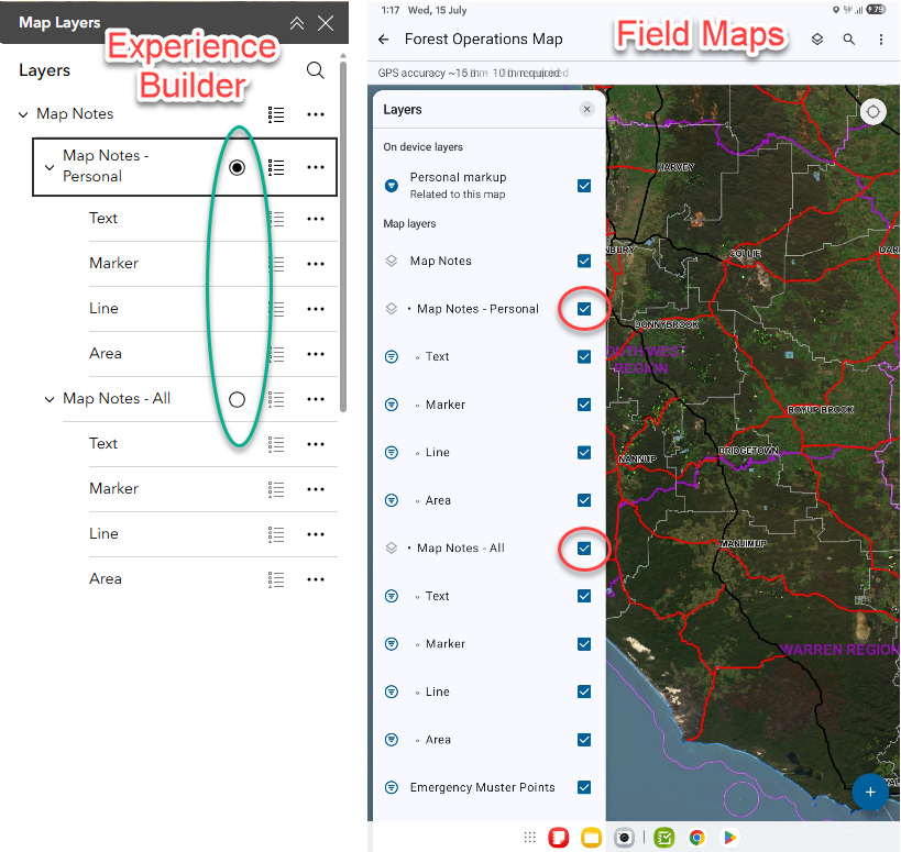

It also works as expected in Experience Builder (left) but not in Field Maps (right). It seems that the layers in Field Maps are still functioning as independently visible, and the bottom one is on by default (when it should be the top one as shown above and in ExB).
P.S. Yes, I am using the latest version of the app and it's on an Android Galaxy Tablet and Phone.

Hi @ColinLawrence . I've just done a really simple test. I added my new feature service to a blank map, set the group to Exclusive Visibility and saved. Went straight to Field Maps and still no exclusive visibility (though the issue might be related to sub-groups or something).
Map Viwer
Field Maps
I've had a call with Esri Support to discuss this. See what comes from it. Things don't get much simpler that what I've just tested though so would be keen to see an example where you have it working.

Ha! You know what, it IS working - it just doesn't appear like it until after you close the layer list and reopen it (no radio buttons - just the check buttons showing both selected when you're making the selection, but once layer list closed and opened again it has updated). I suppose I was looking for the like-for-like radio button behaviour like you get in Map Viewer and Experience Builder.
Thank you for persisting with me. I'll go and update my Esri Support case now. Still think this can be improved to make it clear that the behaviour is there. Have posted an idea requesting this: Update the UX when selecting Exclusively Visible l... - Esri Community
