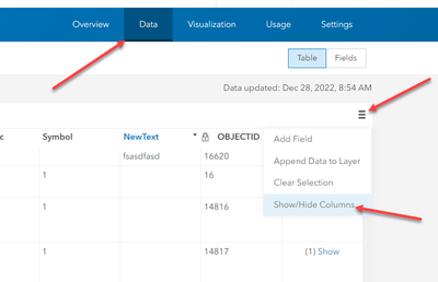

When you add form elements without existing fields, it creates the field(s) in the hosted feature layer for you.
You can see it in the data tab of the item details page, but will probably have to turn on that field to be visible (Same with web map that has this HFL, might need to turn on field visiblity).

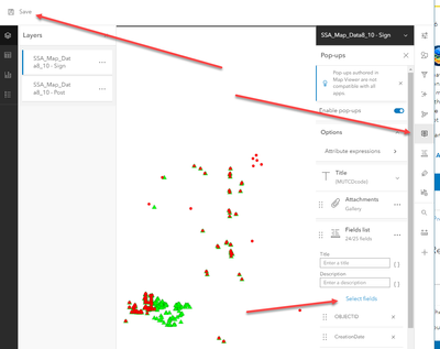

To turn on other fields by default (when you add the layer to new map), go to the item details page, visualization, add the field(s) to the popup config, and the save button in upper right:
