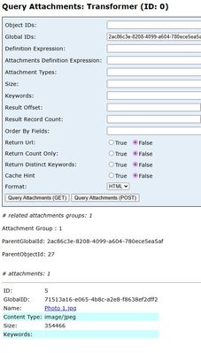

@CoastalEngineering - We do this using PowerAutomate.
There is an action in PowerAutomate to "Get Attachments" that helps us do this.
Looking at make.com, it shows that there is a Make API call action for FieldMaps.
You would make 2 calls - 1) QueryAttachments 2)Download Attachment
You could build up the REST URL using the GlobalID/ObjectID that triggered the process.
Once you have the attachment IDs you can make another call.
https://services8.arcgis.com/xyzxyzxyzxyzx/ArcGIS/rest/services/Asset_Data_Collection_2/FeatureServe...
in the URL above
0=feature sub layer|
27= ID of the parent object
5 = Attachment Object ID
