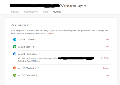

jmcdonald_sdi
When you create a new project in Workforce, you can connect that project to Field Maps in the project settings. Open the settings on your specific project and hit 'Advanced', this brings you to the integration page where you can connect your project to Field Maps. You then choose the field you want to carry over from Workforce and its destination in Field Maps. Once you've made your selection, make sure you hit the add button before leaving that screen.
