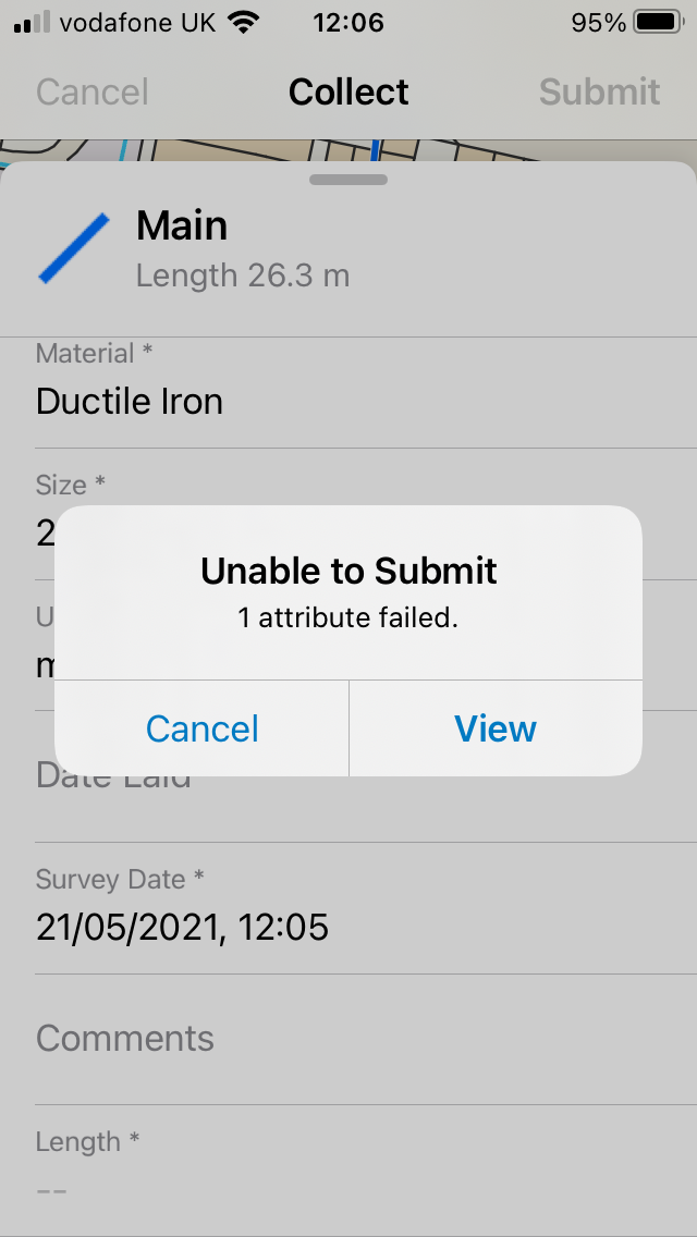

I have an editable feature service (not hosted) where the data sits in an enterprise geodatabase (SQL Server) published from Pro 2.4.2 to the hosting server in ArcGIS Enterprise 10.8.1.  The service contains several point feature classes and a couple of line feature classes. Not sure if I'm encountering a bug or just something to do with the way I've configured things.
In the Field Maps web app I have made some fairly simple forms for each feature class with a few of the fields set as required and some nice hints and formatting.  When it comes to trying to submit a line feature in Field Maps 21.1.1 build 396 on iOS I get the error message below saying Unable to Submit due to an attribute failing - in this case what is shown as the Length field which is Shape__Length in my database.
I am unable to edit the length field on the form in Field Maps and wouldn't want to anyway because it should get automatically calculated for me. I'm also unable to remove the field from the form in Field Maps web app because it is a required field and I don't think I can make it a non-required field (and again probably wouldn't want to).

Hi @GarethBaker1
This was an issue with the first setups that were publicly available for 10.8.1. We addressed this issue shortly after the initial release and re-released new setups (not a patch) for 10.8.1. Can you try removing the currently installed version of Field Maps on your portal and installing the latest setups for 10.8.1 from My Esri? I think this will resolve the issue by not requiring/allowing geometry fields like Shape_Area and Shape_Length to be in the form.
