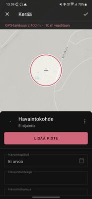

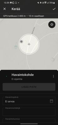

Hi All,
I'm running into an issue with field maps where I can add a point at my location (GPS) but if I move the cross hairs to a manual location, the button to add/update the point greys out and I can't add/update.
It only appears to be an issue with point layers, I can add a polygon to my polygon layer no problem. It also doesn't seem to be an issue with a map I have that uses an offline area. The current map I'm troubleshooting is connected to the server so that the layer changes are automatically updated.
I'm not sure if this is something I have to change in terms of settings, or if it's some sort of bug. Any advice would be appreciated!
Caitlin
I opened a case with Esri and we found a solution. The issue was that my point layer was z-aware but there wasn't a default z-value enabled. Using the GPS location created a z-value, but attempting to manually choose the location would not create a z-value.
I had to go onto my map service on the server and change a setting to enable a default z-value. Here is a link to the steps I followed as provided by my very helpful Esri representative:
Configure default z-values.
