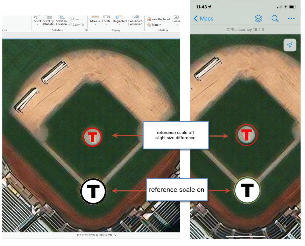

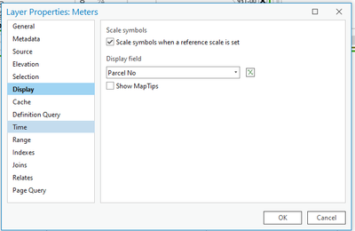

It is a bit of figuring out what size will work best for your mobile worker.    It could be that a sizing property that you are using for you symbol is resulting in the difference that you are seeing.   In past releases, years ago, we did have a very noticeable difference in symbol size but it is much improved today in current releases.   I created this https://www.arcgis.com/home/item.html?id=61e4e3c2dd94485f99fc0c9e6297aee3  using default symbol sizing.  I set a reference scale for the map and for the layer with red symbol I turned off "Scale symbols" in the layer properties.  In the screenshots I am viewing the map in ArcGIS Pro and Field maps at nearly the same scale.

 I think this is what you are referring to? I have it enabled for both layers but still see the change in size.

here is another view of how it looks for me, photo of ArcGIS Pro and Field maps
