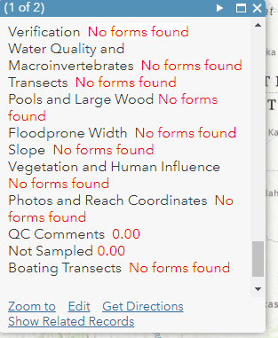

Yes I do this a lot for our field data.  I actually tell them if they got all 12 forms done or not.  I can even do pattern matching so that it makes sure they did 1,2,3 not 2,2,3 for example.  I then use red to make it pop.
All done with FeatureSet just run a query like this.
var EvaluationID = Concatenate($feature.PointID, "_", text($feature.FieldEvalDate, "Y-MM-DD"))
var sql = "EvaluationID = '" + EvaluationID + "'";
var tbl = Filter(FeatureSetByName($map,"Water Quality and Macroinvertebrates", ['EvaluationID'], false), sql);
if (count(tbl) > 1) {
return "More than one form found"
else if (count(tbl) < 1) {
return "No forms found"
else {
return "1"
