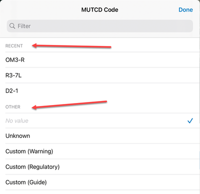

Are you using the latest version of Field Maps?
The recent values is working for me with our without Domains.  It just adds the last few values selected to the top of the list (here are the last three values I entered) and everything else is under "Other".

I just realised that you're right, we can see recent values in Domains. We don't see recent values when there aren't many choices in the domains (and it's the case in most of my fields). Just when there's a lot !
