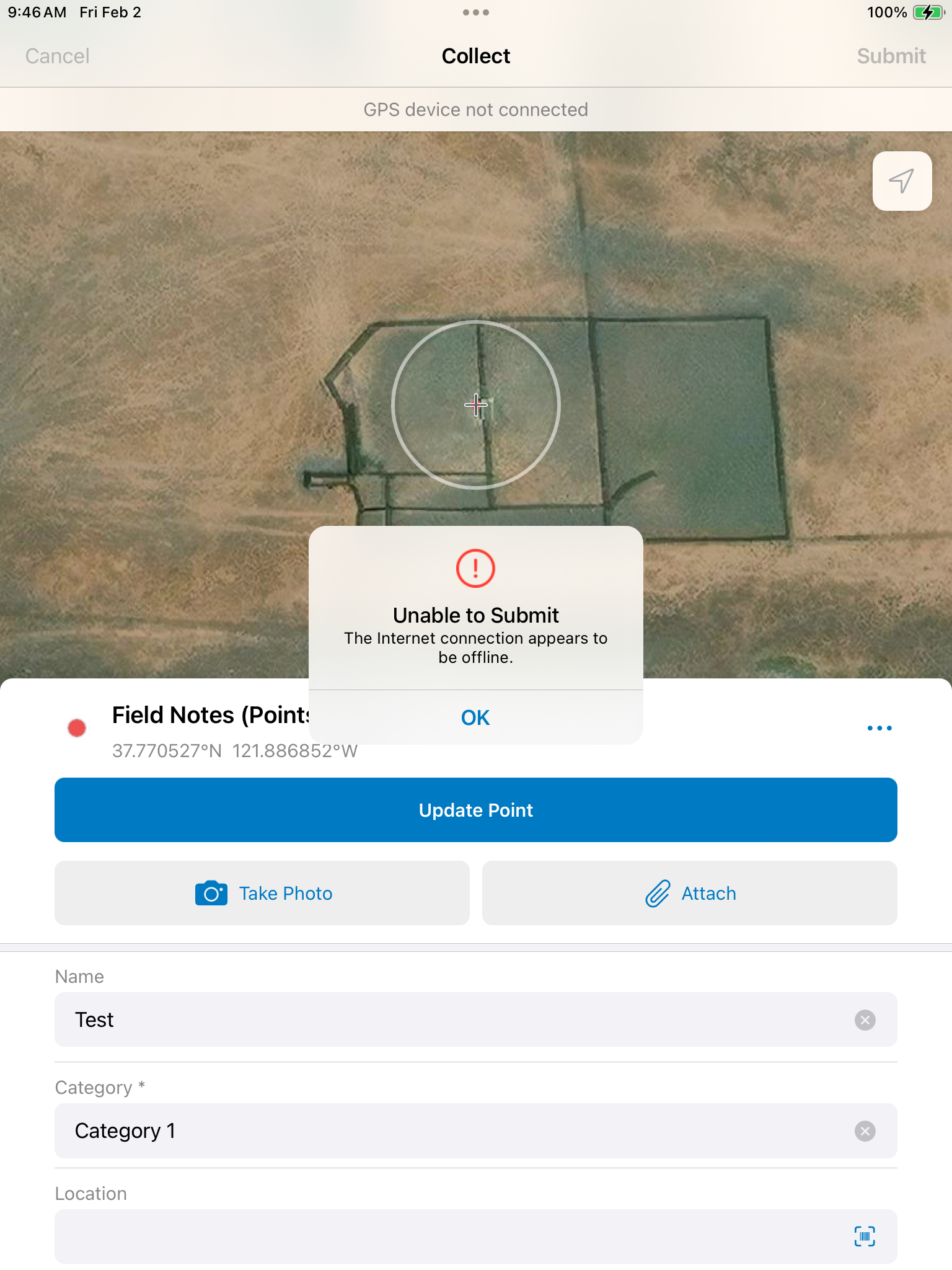

I have an offline-enabled map with an offline-enabled, hosted feature layer I want to use to collect point data using Field Maps in a remote area. When I go offline and attempt to collect/submit a point, I get the error, Unable to Submit: The internet connection appears to be offline.

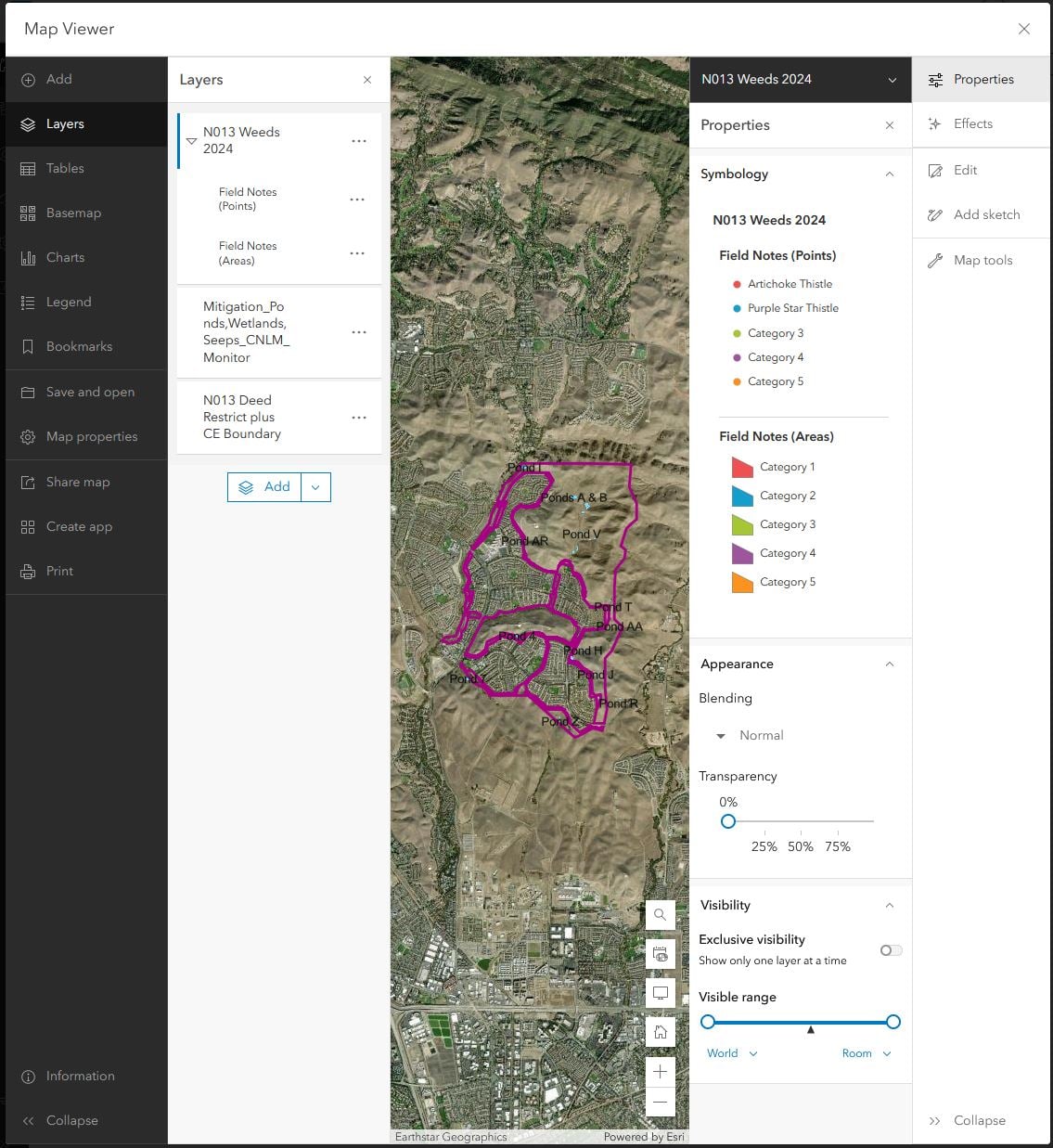

 Perhaps related, I generated the Points and Areas layer from an Esri template in AGOL. ( I have used this template before with success, in another map that functions properly offline).  In Field Maps Designer, Map Viewer Classic, I then re-labeled two of the Categories from "Category 1" and "Category 2" to "Artichoke Thistle" and "Purple Star Thistle", two of the most commonly encountered types of plant I want to map, then saved the layer, and the map.

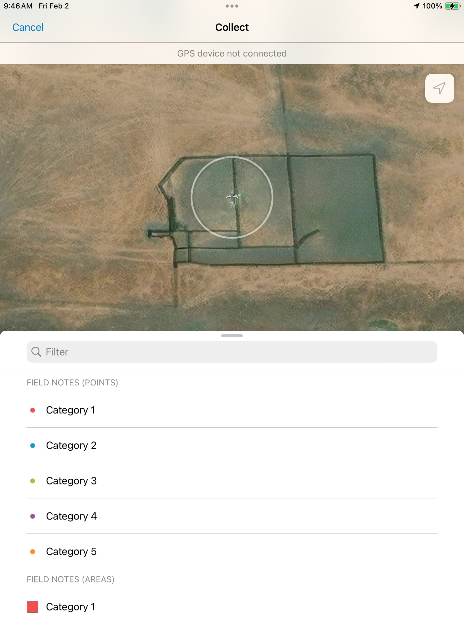

 I loaded the map on my iPad and downloaded the Map Area.  But, on my iPad, the layer does not show the new names, instead showing "Category 1".

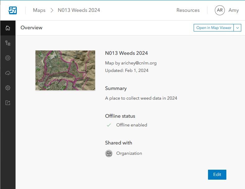

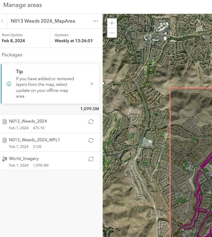

I have done all the troubleshooting I know how to do (screenshots below).  This includes:
1. Completely rebuilding the base map by generating it in ArcPro and sharing it as a Web Map.
2. Deleting the troublesome layer and rebuilding it in AGOL, saving it as a new one, then adding it to the map with Field Maps Designer

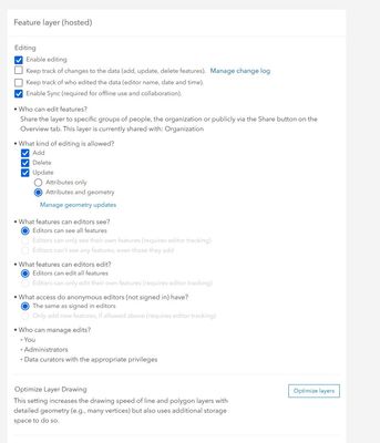

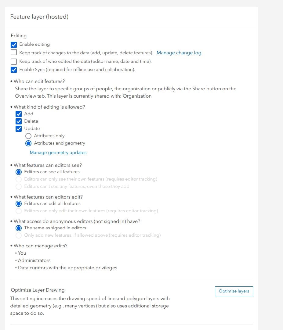

3. Ensuring I have a hosted layer that is editable and sync-enabled

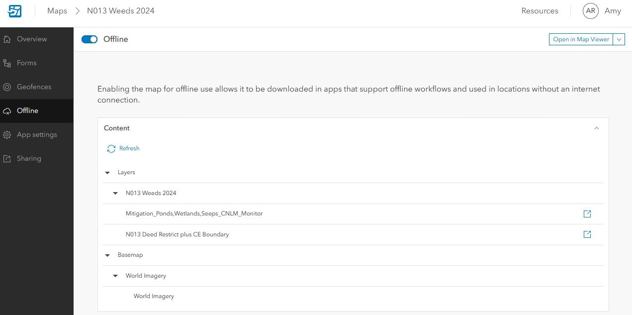

4. Ensuring the map is in Offline mode
5. Double-checking that Map Areas are updated

Update: I decided to, yet again, ?why not try one more time?, refresh the maps on my iPad by pulling down with three fingers.  The Map is now listed under On Device.  I turned WiFi off and just successfully submitted a point!!  The layer still does not register my Category renaming.  An annoyance, but workable as long as e.g., I remember to use Category 1 only for Artichoke Thistle.
Frustrating though, that I don't know why Submit started working.  Seems totally random??
