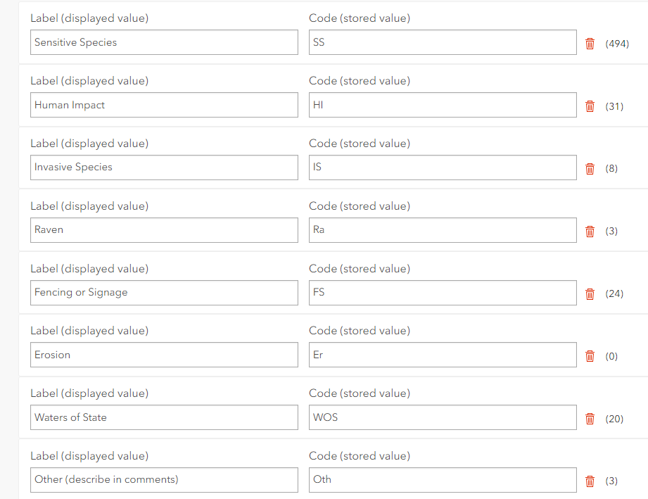

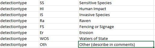

MHCorvus
I guess one frustrating part is that my labels and codes are identical in survey 123 and the domain for the feature as far as I can tell which is something mentioned in that link
MHCorvus
But that did the trick.
I just had to add an attribute expression to pull the DomainCode for that PTType field and use it in the URL instead of the field itself.
I will repeat the link to the post I ended up using. I had to do it even though the labels and codes were the same in both my feature class and survey 123 field, so it seems that fieldmaps is just using the labels
https://community.esri.com/t5/arcgis-field-maps-questions/url-passing-labels-not-coded-values-to-sur...
