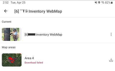

3) On my mobile device, I tried to create an offline area through the Field Maps App while connected to the internet. It fails with no error log or message. One moment its creating it, the next that area disappears from the list.

I get a 'FAILED' error after trying to create an offline area on both desktop and mobile versions of FieldMaps.
