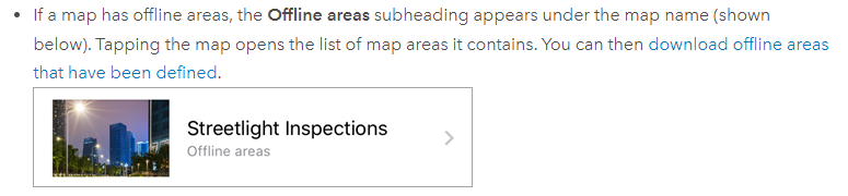

  • Yes. To clarify, when signed into a user's account that I have shared the map with, the offline area does not show up in Field Maps. The below picture is an example of what I see when logged onto any user's account that I have shared the map with. Upon tapping the map to show the offline map area (as the bulleted direction below says), the map area does not appear, and I only see the online map. The below picture was pulled from an Ersi Resources page: Download maps—ArcGIS Field Maps | DocumentatioScreenshot 2023-12-19 132954.png
