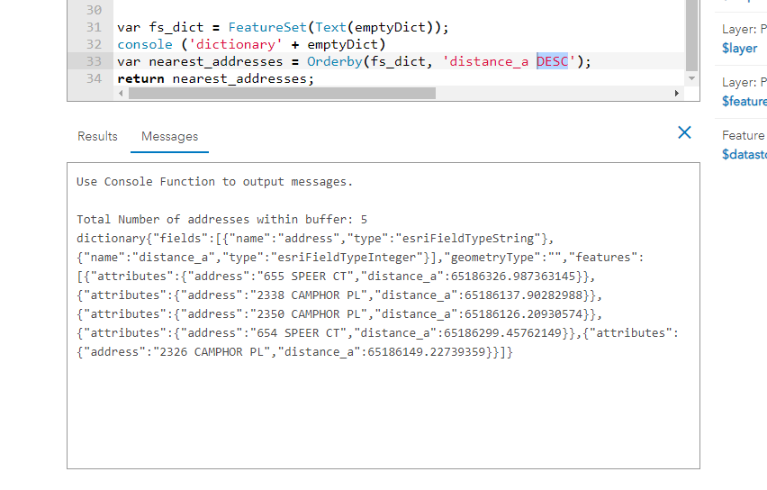

Hello,
I am attempting to auto calculate a field in the Field maps smart form for a hosted feature layer using the new arcade calculation capability. Using the solution provided here Solved: Using Arcade to Find the Nearest Address Point - Esri Community I kept getting wrong and inconsistent results for the nearest address. So I have now switched to making a dictionary and converting it into a feature so I can sort the buffer intersecting addresses by distance to get accurate results. Now I am just receiving null values
Our feature services are in nad 1983.
Here is my code
var search_distance = 150;
var addresses = FeatureSetById($map, /* AddressPoints_Export */ "AddressPoints_Export_5543")
var buf = Buffer($feature, search_distance, "feet")
var intersecting = Intersects(addresses, buf)
var cnt = Count(intersecting)
Console("Total Number of addresses within buffer: " + cnt)
var emptyDict = {
      'fields': [{ 'name': 'address', 'type': 'esriFieldTypeString'},{ 'name': 'distance_a', 'type': 'esriFieldTypeInteger'}],
      'geometryType': '',
      'features': []
var index = 0;
 if (cnt >0){
    for (var f in intersecting){
        var addressDist = number(Distance(f,$feature, "feet"));
        var address_n = f.FULL_ADDRESS
        for(var i = 0; i <1; i++){
            emptyDict.features[index]= {
                'attributes':{
                        'address': address_n,
                        'distance_a': addressDist
    index++;
var fs_dict = FeatureSet(Text(emptyDict));
var nearest_address = First(Orderby(fs_dict, 'distance_a DESC'));
return nearest_address;
Any advice would be greatly appreciated!!
EDIT: I am able to view the dictionary successfully, but cant figure out how to sort and return it as a featureSetconsole_results_dictionary.png

OliverSandoval_p
Hi Aaron,
Sorry for the late reply! I was able to figure out that the Web Map needed to have its projection changed by adding a service as a basemap with a different projection than web Mercator in order to match the layers' NAD 1983. I ended up using my original code based off the solution in the original post, but I had to reupload the hosted feature layers as Web Mercator.
Making sure everything in a workspace including the map is in the right projection is one of the most critical steps, but its something I wasn't familiar with in terms of ArcGIS Online jiminey crickets!!!
Thank you for your taking the time to make the solution!
Best,
Oliver
