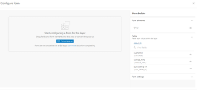

Our field guys use the forms in Field Maps with no apparent issues, aside from some requested changes to the forms themselves.
However, I can't find ANY forms
I have looked in Map Viewer > Layers > myLayer > Forms and looked in Field Maps Designer > Forms > Layers > myLayer but there are no forms to be found.
I can even see in the map a brand new entry that we picked up in the field just this afternoon using the form in Field Maps
ClayDonaldsonSWCA
Ah I see. By default, the field map will use the pop-up configuration for the form if there is not a form configured. Click the convert pop-up button, and that'll let you see what the form looks like to the field folks.
From there you can customize as necessary.

ClayDonaldsonSWCA
Can you clarify what you mean by no forms found? A screenshot could help.
There should be a form per layer in the field map designer.
FORTYMILEGASLTD
regardless of the layer I check. None of them have any forms.
ClayDonaldsonSWCA
FORTYMILEGASLTD
Thanks!
