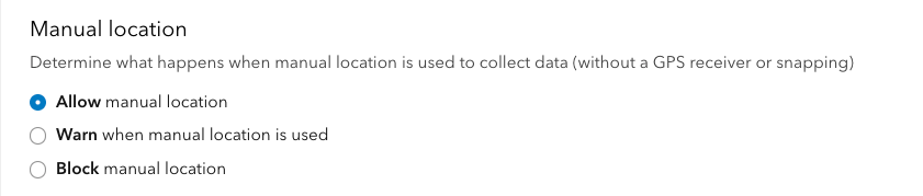

There is a setting in Field Maps Designer for that. Under the App Settings -> Collection, if you choose "Block Manual Location" they will not be able to set the location manually, they will only be able to collect at their current location.

Apologies, I missed a detail here. The setting I pointed you do should make it so a user cannot move a point after initial creation. I think you'll want to keep the manual location disabled - basically after a user drops a point they can pan the map and hit "update point", but with manual location they won't be able to do that.
For your initial ask though, under App Settings in Field Maps Designer, there's also the "Feature actions" section. That's where you can disable "Collect Here" so that they can't drop a pin and collect a feature at that location.
If you disable Collect Here and manual locations, they will only be able to submit points at their current GPS location.

Good news/bad news on this - it seems that you have helped us uncover a bug. The setting to block manual location should give you the behavior that you want - where a user cannot move a point once they collect it at their physical location. It appears that sometimes the App Settings that are configured in Field Maps Designer are not being applied in Field Maps. From what I can tell, if you go into Designer and change one or two settings and save the changes (and then change them back and save again), it will hopefully fully update everything and make it work in Field Maps. We'll be working on some fixes in this area as well now that we know there's a problem. Let me know if it continues to not work, or feel free to reach out via [email protected].
