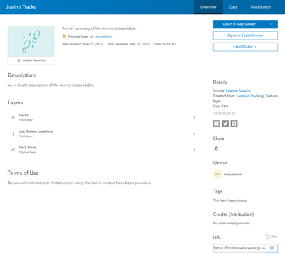

Once the users are configured as viewers, they will be added to a group with the same name as the track view (in the image below, the track view was called "Justin's Tracks").  This group will have feature layer view that you can use to author your webmap as you mention above.
