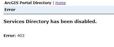

In Portal, the web service rest URL returns this, so I can't obtain the typical rest URL:
If I enter the rest URL from AGOL, I get an error when Field Maps launches advising that layer cannot be found (since the layer isn't being added to the map directly from AGOL.)
