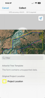

HOWEVER, we are now having the same problem with another field map and it's happening for everyone including me. The layer behaves normally in the online map, and the offline map can be packaged, downloaded and synced, but this is what you see when you try to add a feature:

After a bunch of troubleshooting, it appears the new attachment question is the culprit. When I remove it, the problem goes away. I have tried both a general attachment type and a media attachment type. If either is present, the offline map shows the "The form contains unsupported data" error. I have confirmed this on two different layers. I have also tried reinstalling field maps and recreating both the forms and the maps from scratch. The only thing that works is removing the attachment question. Unfortunately, we need attachments and we need to collect them offline.
