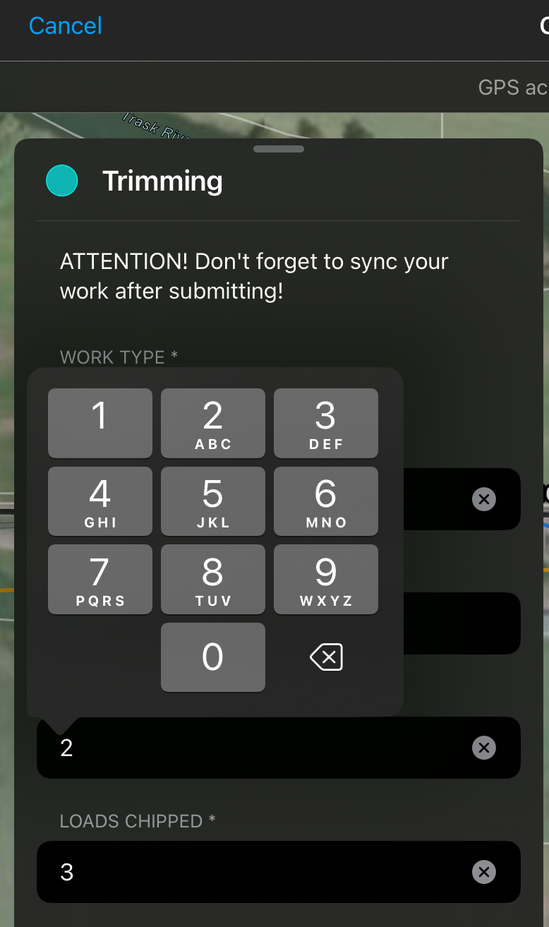

Updated to the latest Field Maps today, and now integer fields display this tiny numerical keyboard, but it's the worst user experience ever.
When I click into an integer input, then the tiny keyboard will display for a second, but it seems like the large keyboard or the footer at the bottom tries to open too, and then they both just close. So, then I click into the input for a second time and sometimes the tiny keyboard will display fine, but other times no keyboard displays at all. So then I need to click into another input and back into it again!
This is not a good user experience at all. The tiny keyboard makes filling out the form very difficult. It also covers the inputs way too much. You can't even see what you're entering.
Is this by design? I sure hope not!
Any idea how I can disable this tiny numerical keyboard for our users?

Hello, thank you for reaching out about this. The team is aware of this and is investigating. Although the small format keyboard is expected for integer type fields, the inconsistent behavior with when/where it appears is not. It seems to be specific to devices running iOS 26.x. Can you confirm what device this happens on and its OS version?

My iPad is running:
iOS: v26.3 (however, other employees are on various 26.X versions)
Field Maps: v26.1.0.2533
Here's a screen recording better showing these issues:
(view in My Videos)
How is it this bad? Maybe your developers need a Claude Code subscription so it can do it correctly for them the first time!

I put in a BUG with support for this so those that are impacted can be attached and track the status. If you provide your contact information I can add you or reach out to Support and mention the following:
BUG-000183302 - Numeric keyboard can block field input on iPads in ArcGIS Field Maps 26.1.0

Fantastic! I will say that the keyboard blocking the inputs is just one of the issues, the even bigger issue, in my opinion, is that the keyboard doesn't stay open. If you watch the video I attached, you'll see that I have to click into the inputs 2 to 3 times just to get the keyboard to stay open. It never stays open on the first click. It's extremely annoying.
