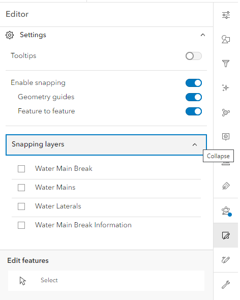

Matt-Huser
It appears like this is now possible but you can only select Feature Service references for snapping.Snapping.PNGSnapping.PNG
