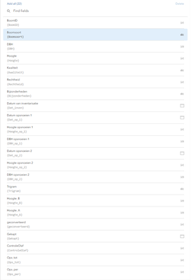

Newest info: when exported as a filegeodatabase and deployed as a hosted feature layer I can see 29 fields when looking at the feature layer - data tab. That seems ok, but when I enter that layer in a webmap and look at the fields with the formsbuilder of field maps designer I see only 19 fields.
Some of those fields have been previously deleted, but somehow still visible. Also i don't see some of the fields that show up in  the data tab of the layer.
formsbuilder:
fields in the data tab:
So, that is something I didn't expect. Anyone any idea?
I read somewhere the form is stored with the feature, ss there a way to strip the form completely from the feature?
