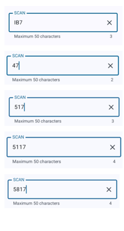

Since our workers migrated to Field Maps 25.2.3 on android, barcodes are not properly scanned.
The very same barcode is decoded with different values each time it is scanned. Here are few examples from 10 different scans in a row of the same barcode:

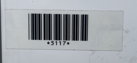

The barcode looks like the following:
So 5117 is the correct value.

Hi @NicolasGIS ,
I can reproduce the issue with the barcode that you shared, though it doesn't happen with any others that I create. Are you seeing the problem on a lot of different barcodes or just this one?
Also, do you know the type of encoding used for the barcode? I tried to recreate a fresh version with the same value but none of the encoding options I used looked exactly the same.

According to them this is Code-39. I kind of confirm it with an external barcode generator:
https://barcode.tec-it.com/en/Code39?data=*5117*
VS original bar code:
They look pretty much the same.
With the first bar code generated from the website above, I can reproduce the issue of ArcGIS Fields Maps not properly decoded it though it happens less often.
