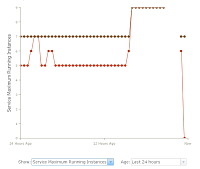

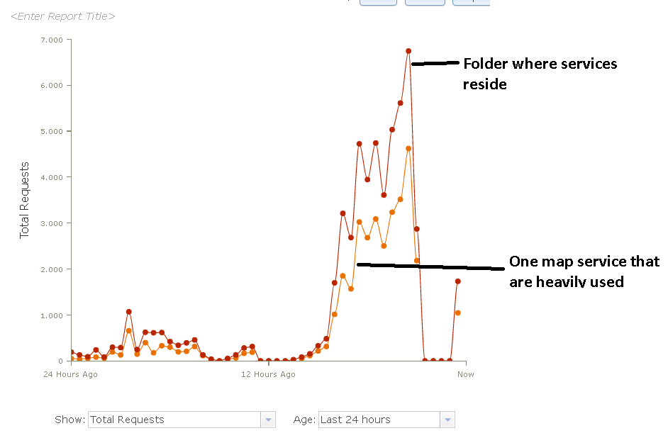

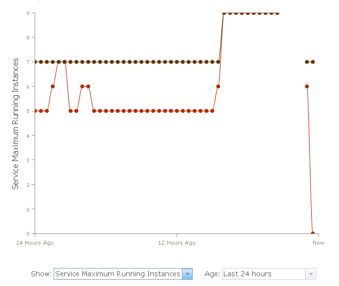

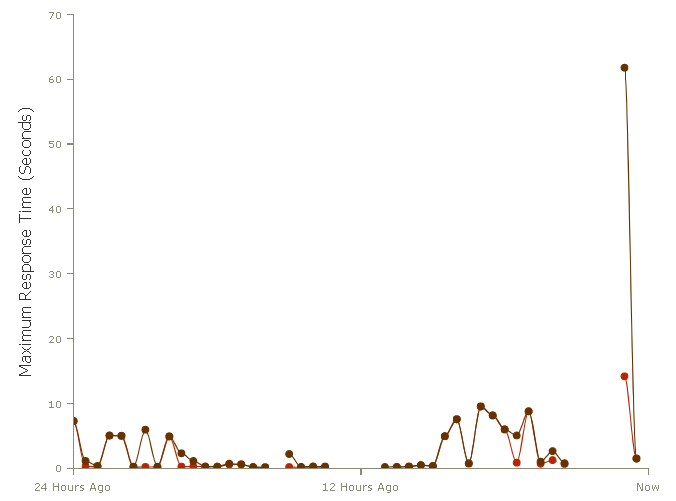

My arcgis server statistics looks like this :
Need some advice to run the whole thing smoothly, at least without crashing.
